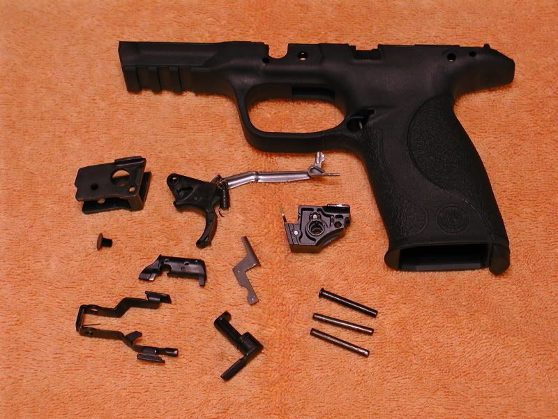

I just had both the front and rear out today for a full cleaning and some polishing. The front rail are attached to a small block that holds the take down lever and the trigger housing/slide stop in place (these are different pieces though). The rear is a part of the sear housing. Both can definitely be replaced if the front assembly is available. (probably free through Smith)
The front locking block(rails), and the rear sear housing block(rails) are easy to take out of the M&P. Yes, they are available for replacement.
Here is mine.

so I guess that's a yes eh? I figured that's what the roll pins were for. anyone know what size the pins are? as the standard rule is you shouldn't re-use roll pins. For my Beretta decocker levers I didn't care, but for something like frame rails/locking blocks it might be a good idea.
I don't know exactly what size the pins are, but I used a 3/32" roll pin punch to remove/install them. The pins are slightly larger than that.
