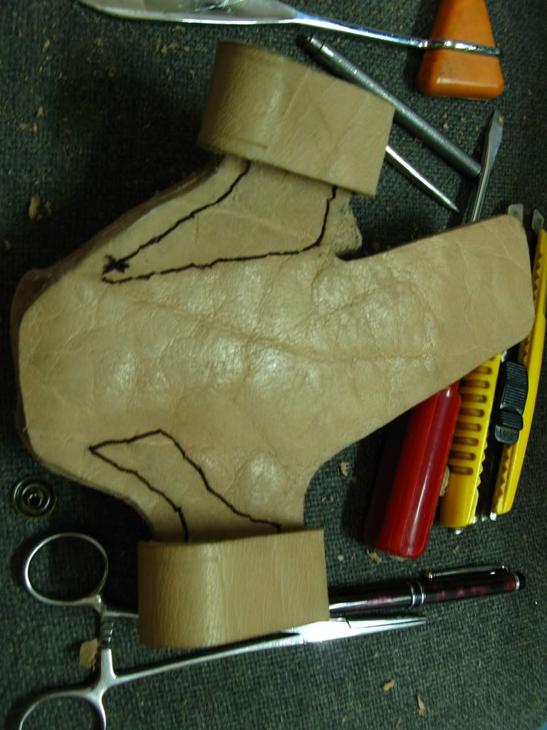

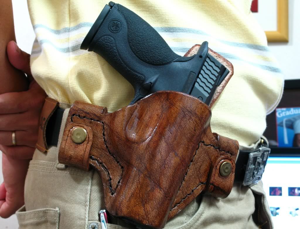

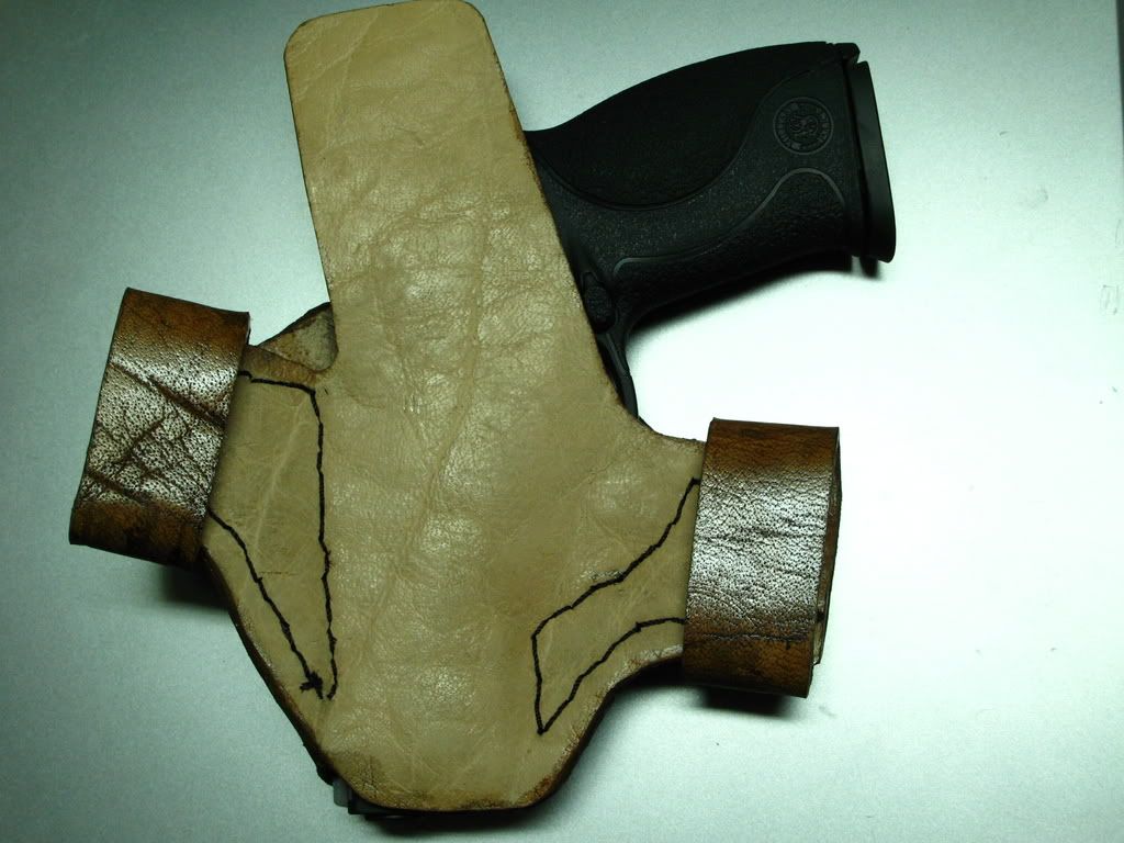

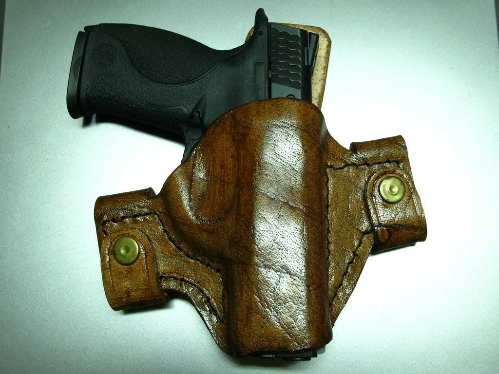

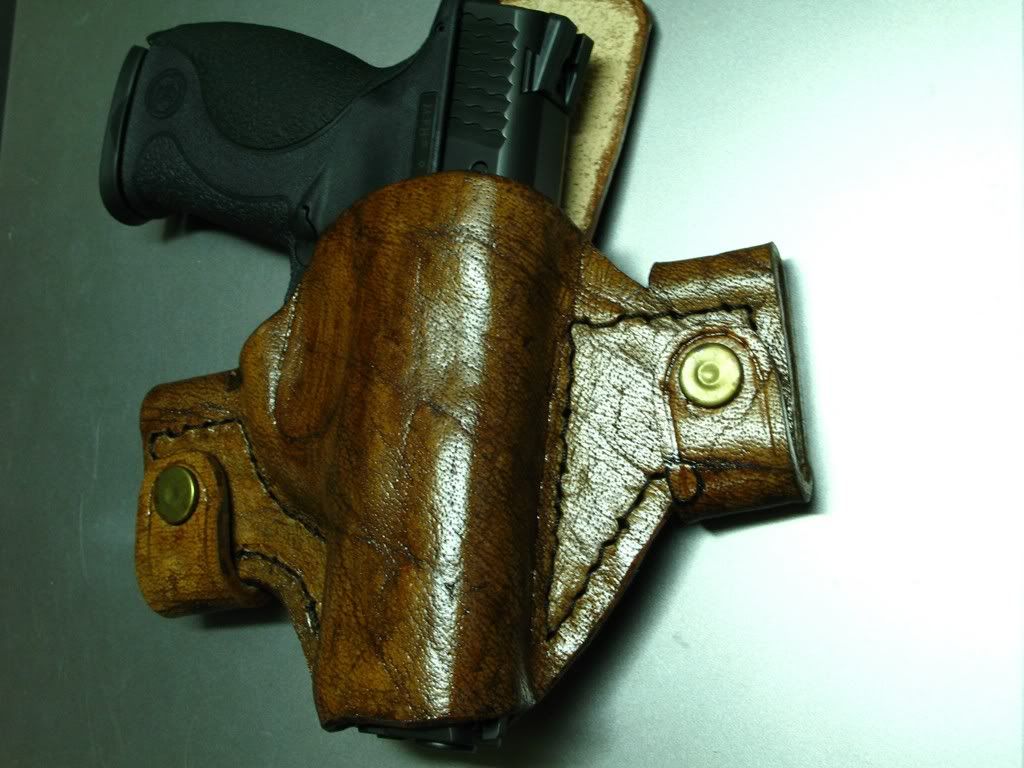

whatever things my hands find to do i always do it with all my might...so i made my own belt holster out of carabao (water buffalo) hide.
natural color of carabaohide
dressed it with brown and black leather pigments
easy snap on

Great looking holster, loloy! Custom made, exotic hide, and you didn't have to wait 6 months.
Jim
Site Staff
9,636 Posts
Looks great! Did you seal the leather after finishing to keep the color from rubbing off on your clothes?
thanks...not yet but tomorrow (24 hrs. after last coat) i'm gonna treat it with linseed oil...

raz-0 said:
Nice holster, but the leather is awfully thick. How much does it add to the width of the firearm.
Pretty, but strikes me as counterproductive for concealment.
thanks...definitely not for concealment or IWB else you'll have a dose of kidney punch everytime you stoop and terribly excruciating if worn over long period. aside from aesthetics i tailored it for my range use only and i preferred a thicker hide for access and easy draw as thin hide will close up on themselves once it's drawn and makes tactical one hand holstering difficult. though it's stony hard and quite strong side holster too. :wink:
