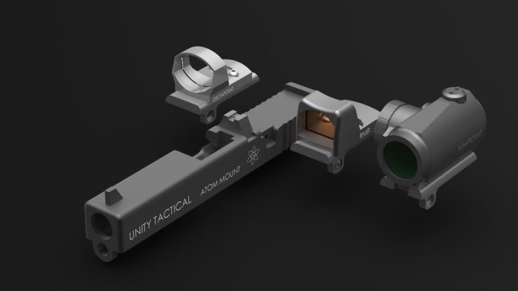

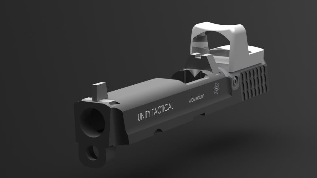

Guys, this is something we have been working on with Mark Housel at L&M Precision Gun Works. Its currently in the prototype phase, but should be ready for prime-time in the not to distant future.
Its a standardized interface system to allow users to get their slide milled once and switch optics as they please. Its also future optic compatible (to an extent), so you won't have to get another slide or get it re-milled for the next generation of micro dots. Simply buy the adapter plate to fit.
We are starting with Glocks & M&Ps using the Aimpoint T-1, Trijicon RMR, and Leupold Deltapoint. Other optics and platforms will eventually be available.
Please let me know if you have any questions.

That looks to be a great design will be interested in seeing how it works out for you. Good luck!
#3 ·
M&P sights are installed and are removed from the ejection port side of the slide. Some poor person might see this pic and drive the sights out or in on the wrong side.

Personal Opinion: You'll sell a HELL of a lot more units if you eliminate the cost of milling the slide!
Design an optic mounting plate system with an integrated tall rear sight BUIS that mounts in the current rear sight dovetail. Package that with a matched-height front sight. So you have 2 pieces that the average guy with a bench vise can install. No milling required!
But then I'm just practical like that...

#10 ·
Although I really like the design, what's the application? Not many guys are going to be switching between different red dot sights on the same weapon
We have an M&P40 slide milled for the J-point/Doctor MRDS, our 1/4 oz. J-point has an integrated rear sight that works well with a factory front sight, and I for one am not interested in swapping it out with a 4 oz. Aimpoint monolith.
#12 ·
Guys, thanks for the responses and interest. The whole project started with a request for a T-1 mounting solution. Surprisingly a LOT of end users want this. The other issue is height of the optic. If you have shot a milled
Slide vs dovetail adapter slide, 1/2" does make a difference. We looked at an integrated sight solution but nixed it for a few reasons.
I think the main draw is a standard. So knowing you can try a different optic, or just buy a new adapter plate for optics that may come out in the future.
The prototypes should be cut in the next few weeks and we are working on getting the adapter plates mass produced.
Thanks again for the interest and comments.

Question, has there been any thought to include on one the the M&P versions a dovetail for wearing standard rear sights?
#18 ·
To answer your question, we thought about it, and there are some considerations for it, but probably not right off the bat, as the gun has sights installed already...
Well guys, here it is, Mark worked his Black Magic with the sights and we have some pictures of the fully complete prototypes. Once we get them back, some will scatter to the wind for testing by other end users, and some will stay with us for testing.

I was just mentioning it for example someone might want to
  • shoot irons with the full sight radius
  • be able to return it back to a somewhat stock look
  • be able to return it to a more easily concealable format without optics
A mount with a length of 1913 picatinny rail would nice as well.
